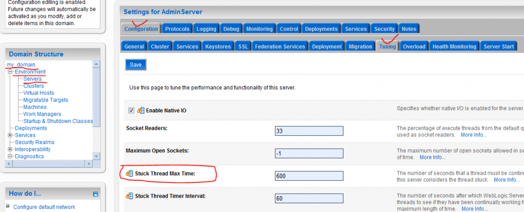

1) 如何修改StuckThreadMaxTime参数值:
启动weblogic服务,进入控制台:
your_domain->Environment->Servers->your_server->Configuration->Tuning->Stuck Thread Max Time
如下图:
